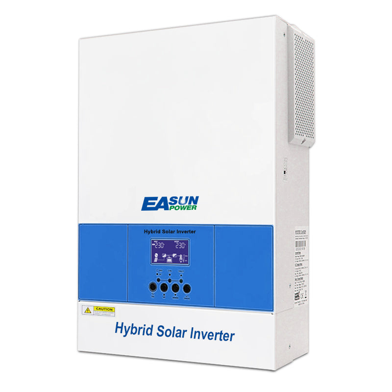

                          Che ne pensi degli EasunPower?
                          https://www.easunpower.com/products/...t-100a-charger
