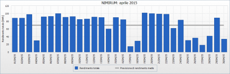

APRILE 2172 kWh 128,37 kWh/kWp 1889 kWh attesi +283 kWh differenza +15%
