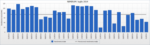

LUGLIO 2460 kWh 145,39 kWh/kWp 2514 kWh attesi -54 kwh differenza -2%
